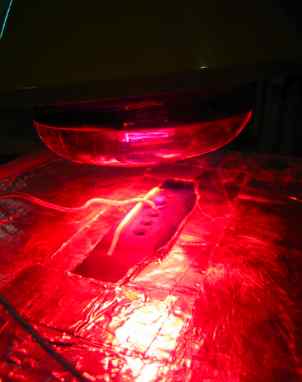

David, you're a busy guy and this probably isn't possible, but could you either explain (or maybe shoot a photo) of "how" you use heat lamps to get the bridge hot enough to create steam with the water, without doing some degree of damage to the surrounding top/finish? I don't doubt you, I've just never seen it. Thanks.
Bill
PostPosted: Sat Nov 03, 2007 3:29 am
Posts: 2060

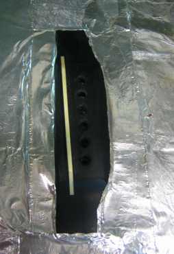

Cardboard, tin foil, HVAC metal tape, and a 250w heat lamp. I prefer the
heat lamp over hard electrical heaters because I feel it easier to control.
The heat is relatively evenly distributed through any dark surface, and you
don't suffer hot or cold spots from uneven contact with a metal heater. I
cover a cardboard mask with aluminum foil, and tape over the bridge
about 1/8" in from the edge with metal tape. If you want to keep heat
away from anything like inlays you can just cover them and their
surrounding area with reflective tape.
As to the steam, I'm not really generating a huge amount of real steam. I
will generally just wet the surface with a wet rag every 30 seconds during
the 3 minutes or so of heating. Most of the water steams off in to the air,
but enough seems to work it's way through to help at least a bit. Without
moisture, fish glue will heat much like hide glue, seeming to crystalize a
crack apart more than softening like PVAs. With this method it does seem
to soften a bit more than with dry heat.

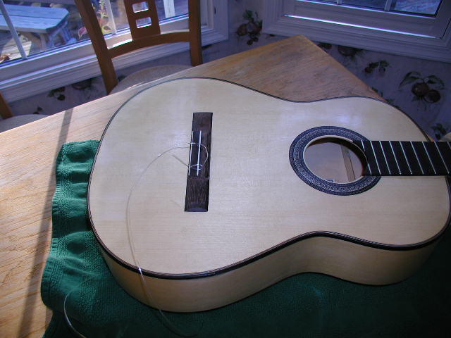

Thanks for all the advice. I would have liked to get to the job this weekend, but I was more preoccupied getting the bridge on for the first time on this one ...
Still have a lot of cosmetic work and fp'ing to go yet.
